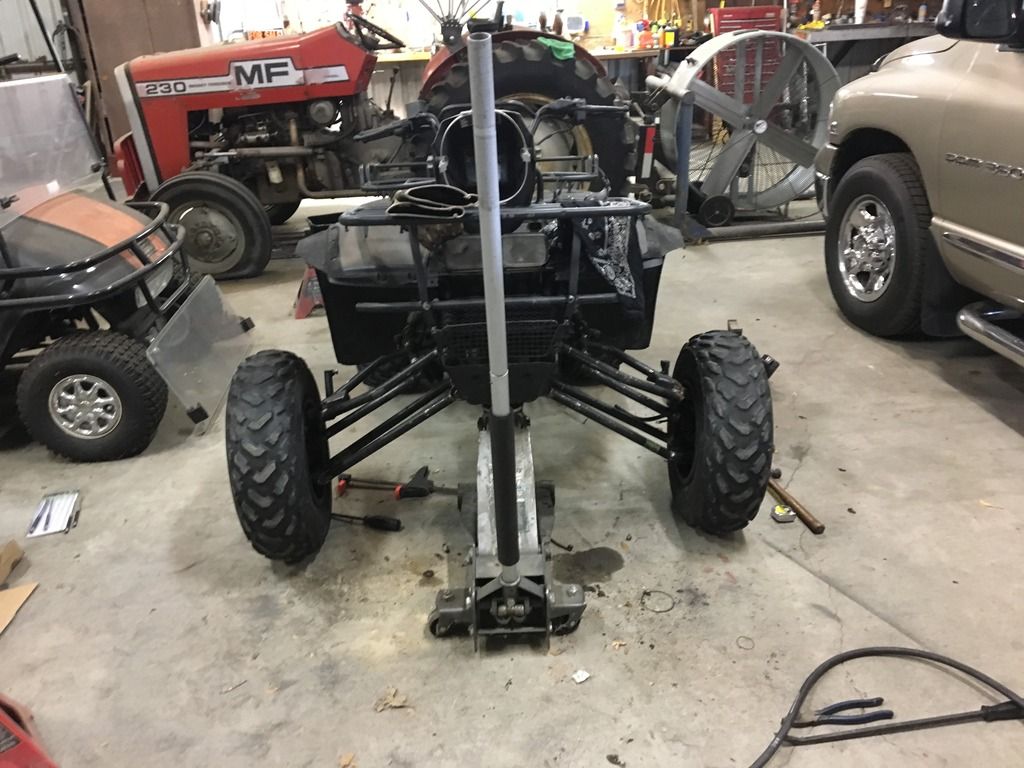

Post some pics up of the rear end so I can cast my eyes on it also. I can probably come up with a good answer for you.

Re: kingquad 300 build 2017/11/03 20:45:18 (permalink)
Alright I’ll see if I have one if not I’ll screen shot one from bike bandit or something. The holes are probably 2 feet apart and it makes a hard turn. I can build it I was just wondering if there is a better way or not.
post edited by 97kq300 - 2017/11/03 20:58:52

Re: kingquad 300 build 2017/11/03 20:57:46 (permalink)
you can even see on his it looks like he added an upper swing arm somehow. unless he used arctic cat rear end parts I don't see how he used 2 a arms. because welding it solid would break or be stiff as a board.

Hi yes I stripped the rear end and welded on new brackets and set it up dual a arm all custom. On the diff I got arctic cat 300 CV cups and they slid right into the king quad diff. Hubs are just king quad 300 fronts haha I modified to fit and they use the king quad front CVS I just need to get custom axles made

Re: kingquad 300 build 2017/11/05 15:54:20 (permalink)
I’m workin on mine right now. Going to try to upload pic real quick.

Re: kingquad 300 build 2017/11/05 17:23:14 (permalink)
I’ll have to do it on the computer it won’t let me through my phone. Give me a minute.I only got the fronts done today. Gotta wait a few days to start on the rear have a few things that have to get done before this bike lol.

Re: kingquad 300 build 2017/11/05 18:48:18 (permalink)
Had to shut her down for the day. gotta stretch tie rods and get some stiffer shocks. not as pretty as zoolanders but I bet she holds together. I laid some steel on them bad boys.

Re: kingquad 300 build 2017/11/05 19:05:11 (permalink)
Looking good. To bad you did have a pipe bender and put some bad a ss arches on them!!!

Re: kingquad 300 build 2017/11/05 19:29:14 (permalink)
Yeah I can redo them later. It wasn’t very hard. Just tried to recreate the old ones. I had to bend those by hand. Schedule 80 is no joke. I only made 1 bend on the tops and the bottoms are straight. I still was a little off but I don’t think it’s enough to matter. I’m definitely not as good as some of these guys out here. But I can come up with something else down the road. This was really just a test for me. I’m only 20 and fairly new to fabrication so I’m trying to learn as much as I can.

Re: kingquad 300 build 2017/11/05 19:30:48 (permalink)
If I was to arch them the axle wouldn’t be outside of the a arms would it? That’s my biggest fear is hitting it against something. When I got this four wheeler the right side of the bike front lower a arm was crunched pretty hard.

Re: kingquad 300 build 2017/11/05 19:50:55 (permalink)
Yes you can build arched a arms that keep the cv axles inside them

Re: kingquad 300 build 2017/11/06 15:28:16 (permalink)
your pic won't show up for me ?? anyone else?

Re: kingquad 300 build 2017/11/06 19:38:41 (permalink)
It showed up when he posted it but no anymore, he must have deleted or moved the picture

Re: kingquad 300 build 2017/11/06 20:00:37 (permalink)
doveman1
What kind of riding do you do
`I want to start going to Jacksonville so I want some good mud tires. I'm limited to wheel size too. ive got some 12s on the way I'm going to modify to fit.
post edited by 97kq300 - 2017/11/06 20:01:38
#57
00_NUTT
Moderator
  • Total Posts : 2735
  • Reward points: 0
  • Joined: 2014/02/11 10:12:30
  • Location: Oberlin, La
  • Status: offline
Re: kingquad 300 build 2017/11/06 20:10:24 (permalink)
http://forum.highlifter.com/offical-honda-300-pic-thread-m2634093-p95.aspx
Check my a arms out in the above thread. Then you can see the possibilities are endless. As far as mud tires 27 gorilla's or outlaws maybe some black mamba lites in a 30 maybe.

doveman1
Super Swamper
  • Total Posts : 2636
  • Reward points: 0
  • Joined: 2008/06/11 09:51:16
  • Location: Marshall Texas
  • Status: offline
Re: kingquad 300 build 2017/11/06 20:30:36 (permalink)
Would look slick with a 26x12 outlaw all the way around, but it'd be hard on everything. Maybe a 28x9.5 outlaw.
You could probably find a shop with a tubing bender to arch. If you meant Jacksonville Texas I can give you a name of a guy that would probably do it.

00_NUTT
Moderator
  • Reward points: 0
  • Status: offline
Re: kingquad 300 build 2017/11/06 20:39:14 (permalink)
Harbor freight got some good benders on the cheap.
