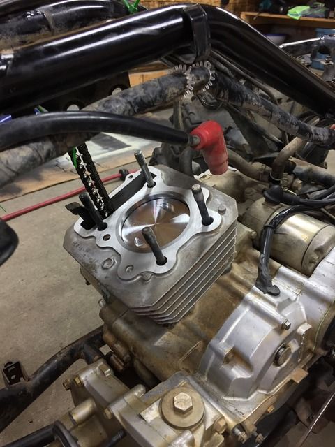

Re: Operation Big Bore 2016/10/13 11:48:20 (permalink)
Heres where I'm at now....
Everything is coming along very good. I'm going to sand the control arms, then apply rust converter & bedline.
Have to pick up new OEM balljoints, & wheel bearings. I refuse to use All Balls anymore. My personal experience is that they wear out a lot faster! There is new All Ball bearings installed in the hub now. They will be removed!!!
The steering stem bearing & bushing appear fine with no play. I'm going to take the bushing off and grease it up though.

Re: Operation Big Bore 2016/10/16 21:00:14 (permalink)
Made very small head way this evening. Just got back home from a nice mountain getaway....
Managed to get the transfer case output shaft deal out and replaced. When I went to grab a new input diff seal, I realized that was the seal I didn't have any was on back order. The two axle seals look like they will fit but are a lot different than what's in there now. I have two seals which are supposed to be for the propeller shaft. WAY too large. So tomorrow I'll hit up Honda and see what's going on.
I got the steering shaft off, greased up, & new tie rods installed. I managed to get the control arms all sanded, rust converter applied, & I'll get the primer & first coat on tonight. Decided to go with gloss black over the Bedliner. I'll post up more pics tomorrow.

Re: Operation Big Bore 2016/10/18 06:07:51 (permalink)
This is where I'm at now...

Re: Operation Big Bore 2016/10/28 16:17:13 (permalink)
Out with the old, in with the new!
#28

Re: Operation Big Bore 2016/10/30 08:32:50 (permalink)
Freshy fresh top end!!!!!!
