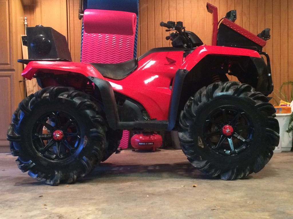

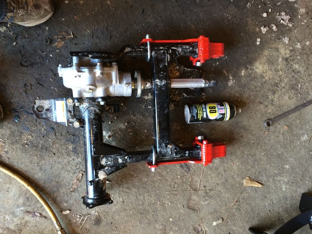

Re: Honda rancher 420 stretch 2016/12/02 17:29:31 (permalink) ☄ Helpfulby Dvicknair812 2017/01/10 21:31:51
me
2 inch lift in both pics 28-12-12 mudxillas
stretch in bottom pic.
31 outlaws with no cut plastic.

How much stretch is this? I'm wanting to clear 32s with the floor boards still on. I'm guessing you have to lengthen the drive shaft?

2 inch lift 2.5 inch stretch
34.5 outlaws with my kit require plastic mods

your current rear lift will be 2 short when rearend moves back 2.5 inches. Because lower rear shock mount moves 2.5 inches
